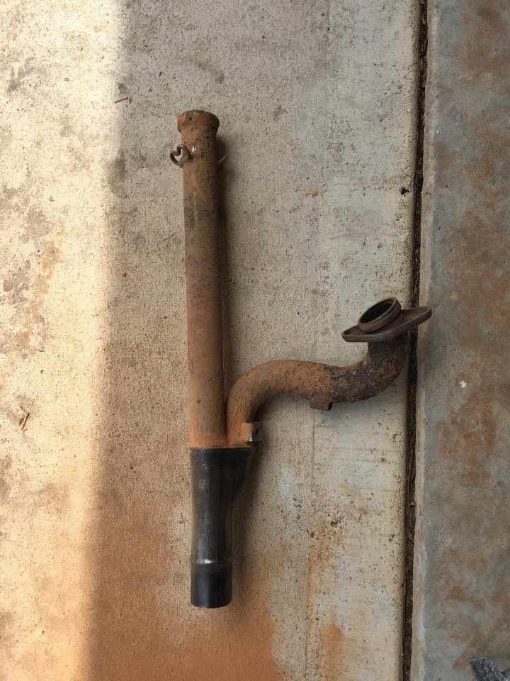

The exhaust definitely had some baked on mud! So, I decided to use my wheel grinder to get the mud off and grind it back down to the metal. Once I got it down to the metal, I used some high temp header paint and coated the entire thing black. Since I'll be riding this a good bit, I decided to do an exhaust wrap to help with the heat.
My "tree ornaments"!
Exhaust wrap applied and back on the outty... PITA to do! There's one bolt on the rear exhaust header that is a beast to remove.... Patience is your friend! While I was at it, I re-applied new heat tape on the gas tank... Just so I don't go up in flames! The old tape as you can see, needed help.

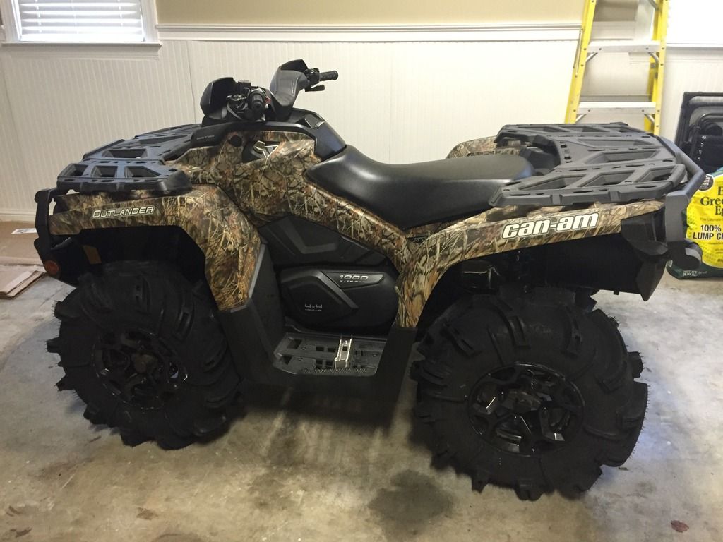

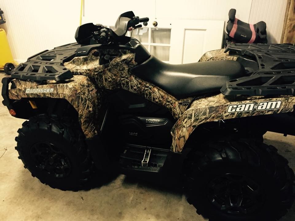

I also replaced the rear metal bumper, the rear linq rack and rails (original one broken), the clutch cover with new decals on both sides, new right fender with decal, new right foot board, stainless steel can am foot pegs, new can am grips, new inner fenders on the front right side, new air filter and gasket, new synthetic rope for the winch, Extreme front bumper (which I love!!!).
Next up, wheels and tires!!! I'm just now going through the process of deciding on which ones to go with.... I'm currently stuck on Outlaw 2 28" with some MSA M17's...shifting between black and bronze... Honestly, the bronze looks pretty slick!

Looks nice. I would be worried about the heat tape on the exhaust. It holds water and leads to the exhaust rusting quicker.
I didn't put the heat tape on the exhaust...only on the gas tank to replace the original factory tape that had come off... Only thing on the exhaust is high temp DEI paint and Titanium exhaust wrap.
https://www.designengineering.com/c...wrap-kits/titanium-exhaust-wrap-lr-technology

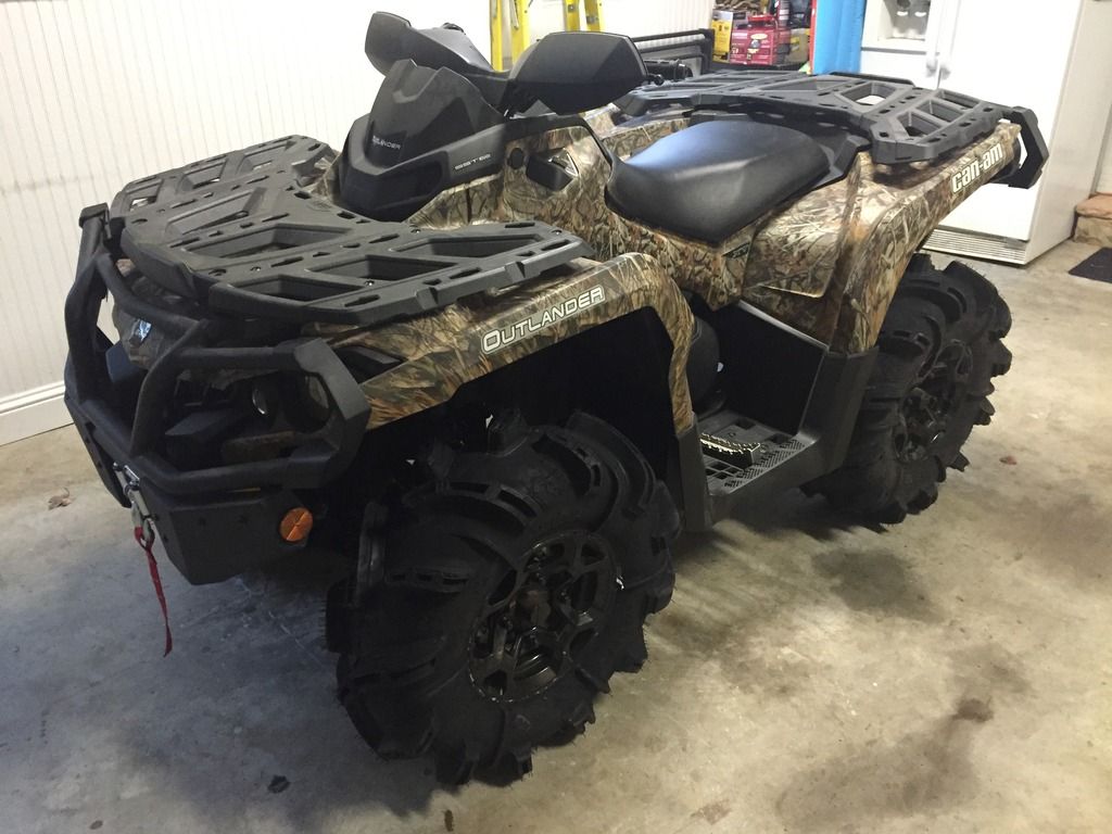

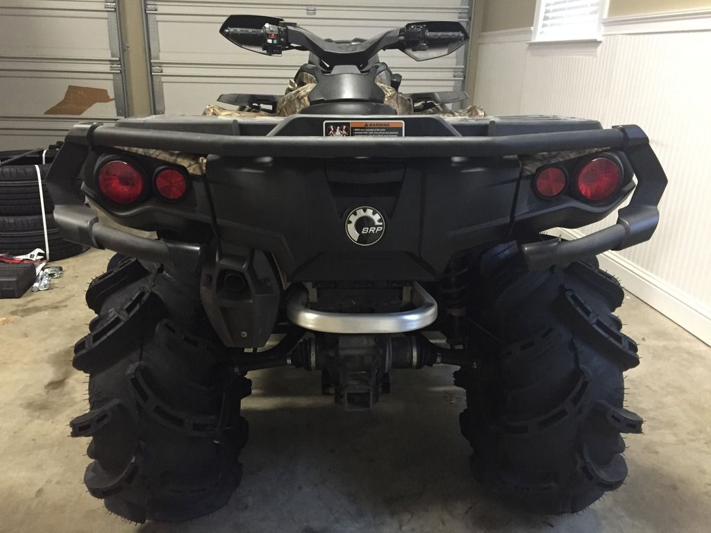

Well after looking at several wheel / tires combos I finally decided to pull the trigger on some 28" Silverbacks! Man I love the way they made this thing look. It's an absolutely perfect fit with a 1" rear wheel spacer. Still need to install the 1" spring spacers to add a little height but they still look great even with the stock height.
