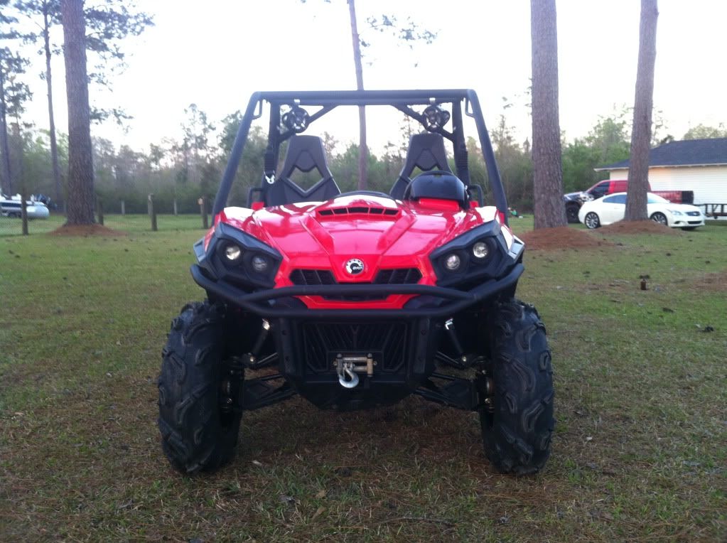

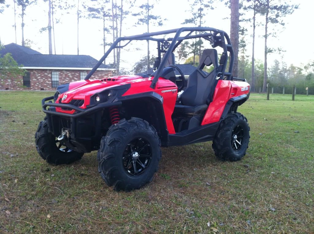

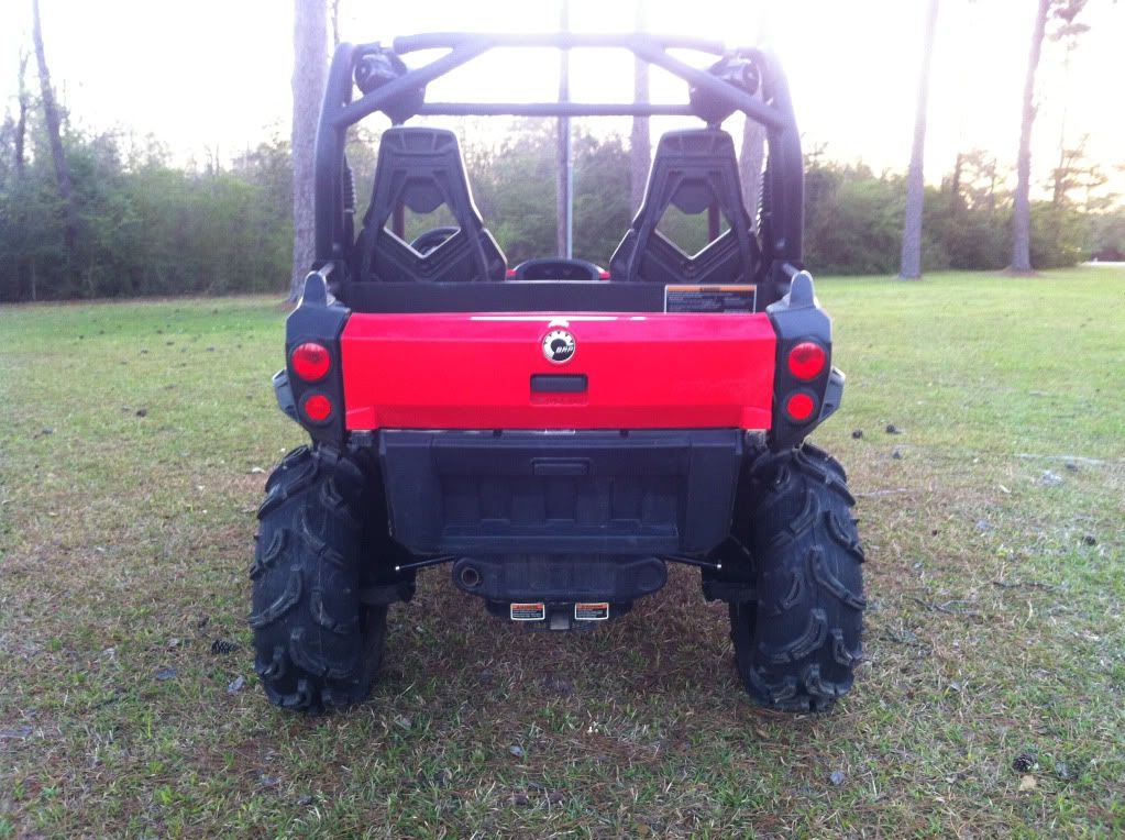

They fit the xt just fine, but the rock sliders on the X will have to be trimmed as stated above. Here is some pics of my xt before I put the 2" catvos on.
#6 ·
I run 30 inch radial outlaws and had no problems with clearance on my 2012 xt with normal riding, but when it comes to riding jeep trails and uneven terrian you will rub under the front fender sometimes. I also just added a backseat and roll cage and when I have some people or kids that weight will sometimes cause it to rub at the top of the fender wells in the back. I also have the shocks cranked all the way up, so thats why I'm currently looking to put a 2 inch lift or puck lift to help with the issue. But, just to let you know the Outlaw Radials...totally Rock!
