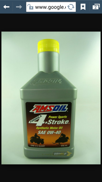

Oil questions always bring out different opinions. I like the 0w-40 Amsoil. :smilietwocents:

This is what is recommended in other post on this site.
shmoky
This is what I have used in my renegades since new
