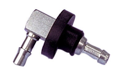

This JonnyDear/Traxter 500 has two leaky fuel lines at the tank. Old stiff rubber fuel lines + old rotted rubber plug-fittings = sad story !
We have new fuel lines, the off/on/reserve valve, the inline filter, and a good clean fuel pump, but,,, this rubber-stopper-thing is a disaster waiting to happen !
The first (good) motorcycle molded tanks had molded-in brass fittings which accepted standard threaded petcocks.
These 'modern' re-molded-trash-containers are... thats another story.
How thick is the plastic ? Can we cut threads and screw in a nice brass bulkhead fitting ? I hope there is some magic fittings that can be used to avoid removing the tank. Any suggestions ?
Thanks in advance.
You might still have to pull the tank....the 90s may have had poly line/in tank filters attached inside the tank...if youre lucky they are still attached and pull out with the grommets/fittings.
I wasnt.
Twice
Moose poly line and metal 90s should fix it for good. Dont know if you can do what you want to do and ditch the rubber grommets altogether?
Thatd be even better.
Good luck hope it works let me know if it does I wouldnt mind eliminating that whole weak link.

Got the elbow-fitting on-order. Thanks - you may have saved the day !
Also, thanks for the info on the internals. Being an old dirt-biker, I don't want anything inside the tank.
As a rule,,, if it gets gasoline from a can, it needs an $5 automotive (metal can) inline filter.

#11 ·
Done. Found eBay threaded brass elbow fittings. Female threaded for 1/4" barbed-inlet fitting.
3/8" extra-length male threaded thru tank. The tank holes were drilled 1/2" (oops!).
Teflon washer on outside of tank (bulkhead in plumber's terms) plus 1/2" O-ring spacer.
Another teflon washer + brass washer & nut on inside. No inlet screens.
Inline filter before carb connection.
