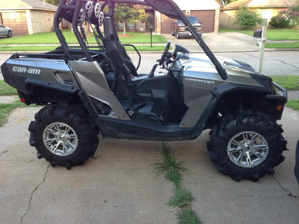

I want to get some 30s Gorillas silverbacks on my commander xt 1000 and I wanted to kno if I needed to do my axles or ill be ok with the stock one and a 2.5 lift
The 2.5 inch lift may cause some axle issues.. how you drive also is a big factor. Personally i would run the stock ones till (if) one lets go and then switch.
2.5 inch lift want be too bad on your axles can am does have probably the biggest stock axles out of any on the market ... I have the same set up... But like Rene800 said " its all about how ya drive it" THROTTLE CONTROL haha
