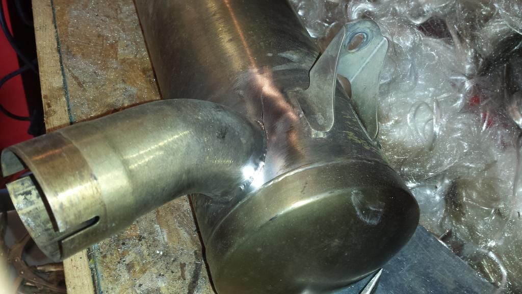

my swamp xl has shit the bed and craked at the inlet pipe and through the case at 40 hours. from what im reading this dosent seem to be uncommon, has anybody delt with customer service? i sent off an email to see where it goes. not really impressed and not to mention the discoloration after 2 hrs for a slip on i pay 460 n tax for!...any body running of of these might wanna take a look.i can easily tig weld it in a couple mins but i shouldnt have to.
1,044 Posts
Contact [email protected] he is your best contact in resolving that poor craftsmanship, the swamp series on the renegade 1000's are a poor design that has too much heat build up at that point which I'm sure caused that failure
Definitely a cause of design and the undercut of the weld as that's where it looked to have started from

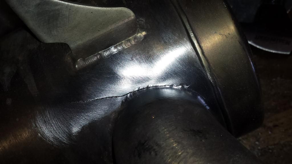

Discussion Starter · #3 ·
Hard to see but the crack carries on down the side of the pipe as well
