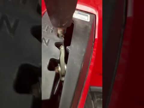

I added a video, I didn't know how to actually put it in the post, it was rejecting it :unsure:
You can hear the high pitch noise somewhat, its hard with the wind on the phone.
