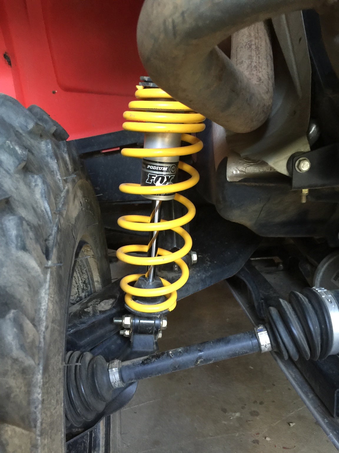

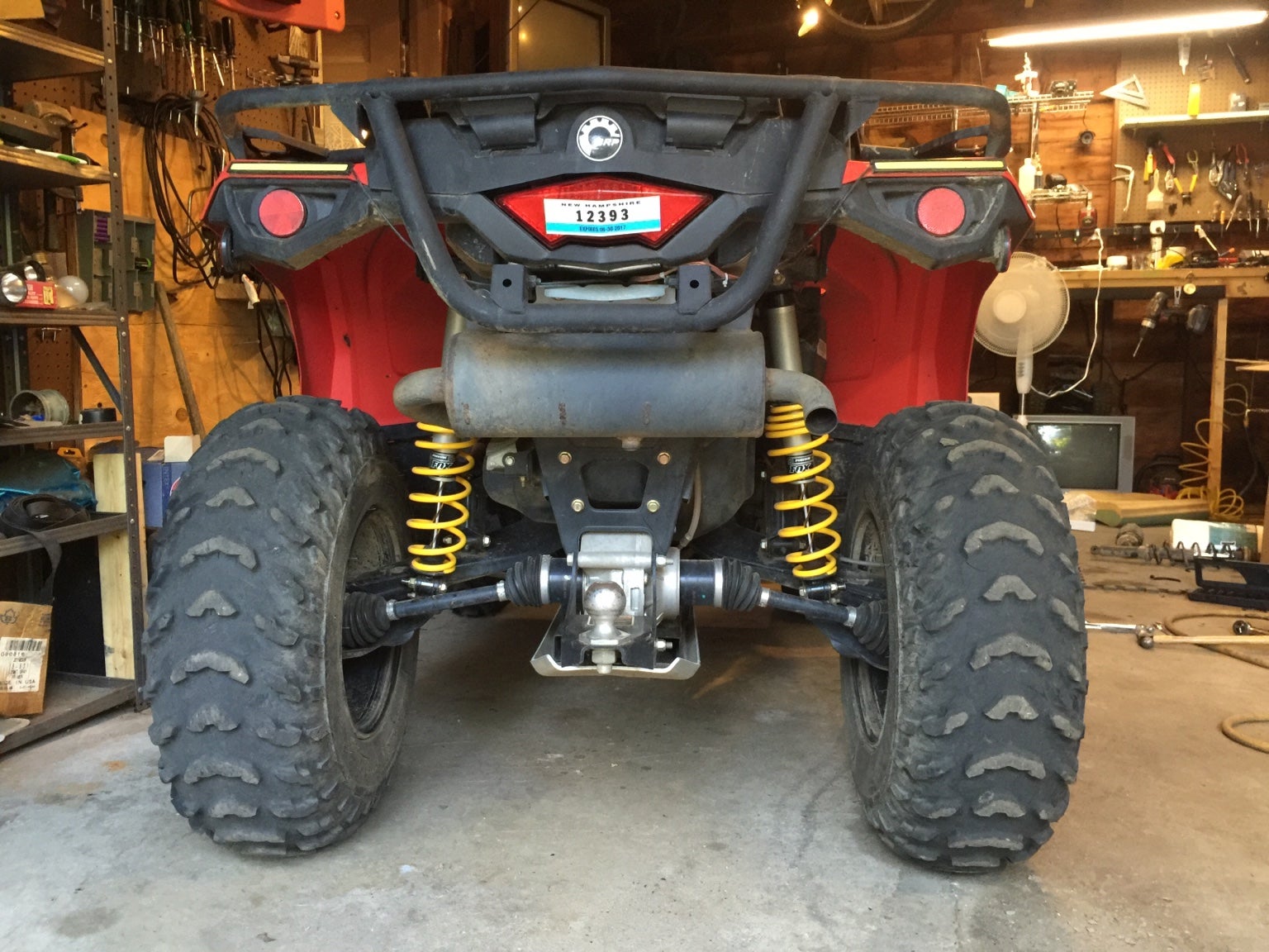

Nobody can confirm that fox shocks fit on an outlander l model. Can-am doesn't list the l model as fitting with the $580 dollar fox shocks. I have a 2015 outlander l 500 max and they fit. Good news. I risked it and it is a direct easy fit. I had a super atv lift and removed it because the shocks lifted my machine another 2 inches because of spring. I took like an inch off the preload they came with. The rear lift bracket hit a little bit the stock mounts are fine. I can actually monster truck over obstacles now. I wish someone confirmed the fit sooner. A must upgrade for outlander l. I found myself bottoming out a ton in New Hampshire. I will confirm performance after next long ride. It resulted in about an inch of lift over stock I would say. Anyone want to buy my stock shocks?

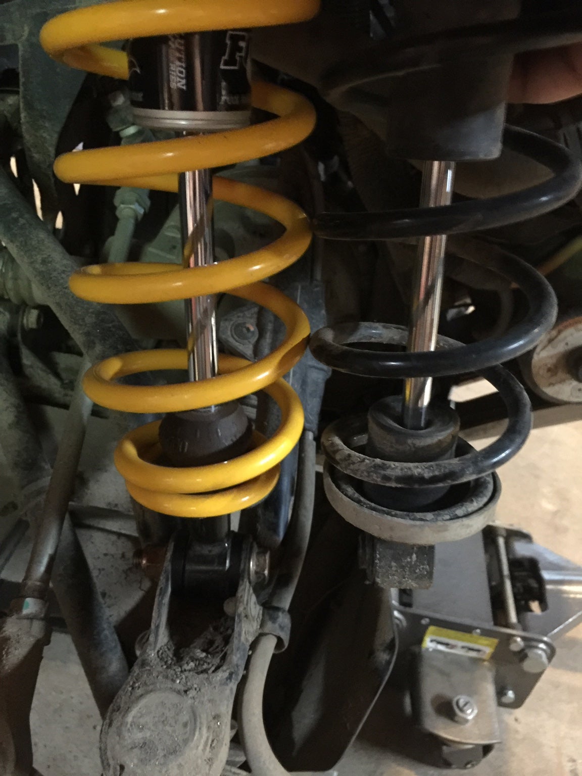

This comes back as a Renegade rear shock when I do a web search. Here's the problem. I may be really dumb here as I've never installed shocks before but shouldn't the bottom eyelet be rotated 90 degrees? They are both oriented in the same direction and will not fit. Can I just put the top in and rotate the bottom until it is oriented correctly?

#53 ·
Here's what I'm talking about
Pretty sure yes. Put a screwdriver in both ands and twist. If it doesn't budge you have a problem. Pretty positive there is no key way in there.

I can confirm that the stock rear springs on the max has a higher spring rate then the rear springs on the Fox upgrade package. I went from maximum preload with the upgrade rear springs for just riding solo to 4.75" of thread showing and 5.25" with my wife on the rear with the original rear springs reinstalled. Neither of us are light by any means. Yesterday we were out and hit a few whoops hard and never bottomed out yet had a comfortably ride. She doesn't go out riding with me much since the grand kids came along.
#63 ·
Was the rear end of the Max unstable with the upgrade shock and spring? And how do the front springs of the original shock compare to the upgrade front springs? In pictures the upgrade spring looks bigger than the originals?
