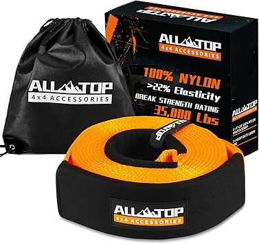

I prefer a strap because it can be stored much easier than a rope. What you need depends on the vehicle you are using it for, and you may wish to buy more than one, because the truck would need a much heavier strap than an ATV (30,000 lbs vs 10,000 lbs). Even using a strap, a 30,000 rated 20' or 30' strap is going to be quite bulky for an ATV. I keep different recovery gear in each of my vehicles. In my ATV I keep a 20' 10,000 lb rated strap, and both hard and soft shackles. In my Defender I keep 2 30' kinetic straps rated at 17,000 lbs and at 30,000 lbs.; 2 soft shackles; 2 hard shackles; a 100' winch extension rope that is not kinetic; and a snatch block.
The All Top recovery kit you linked looks good. I think the All Top products are the same as Gear America, but with a different brand name.

I went with this. Same as before but only 20 feet, and no shackles. I gots plenty of shackles.
