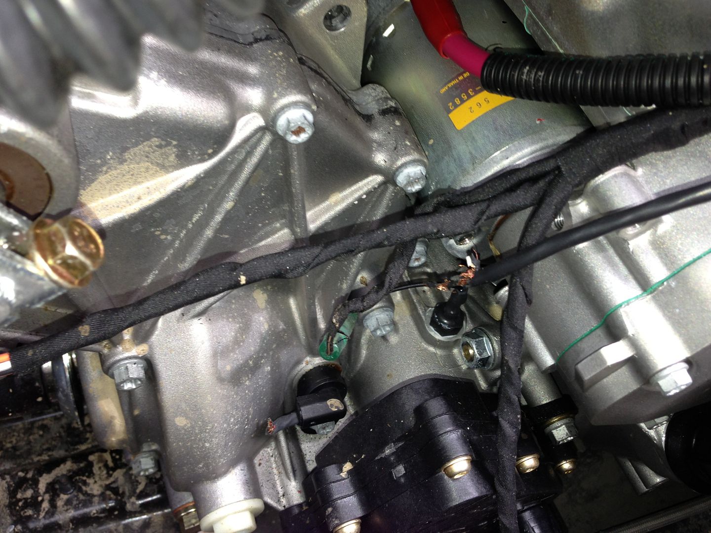

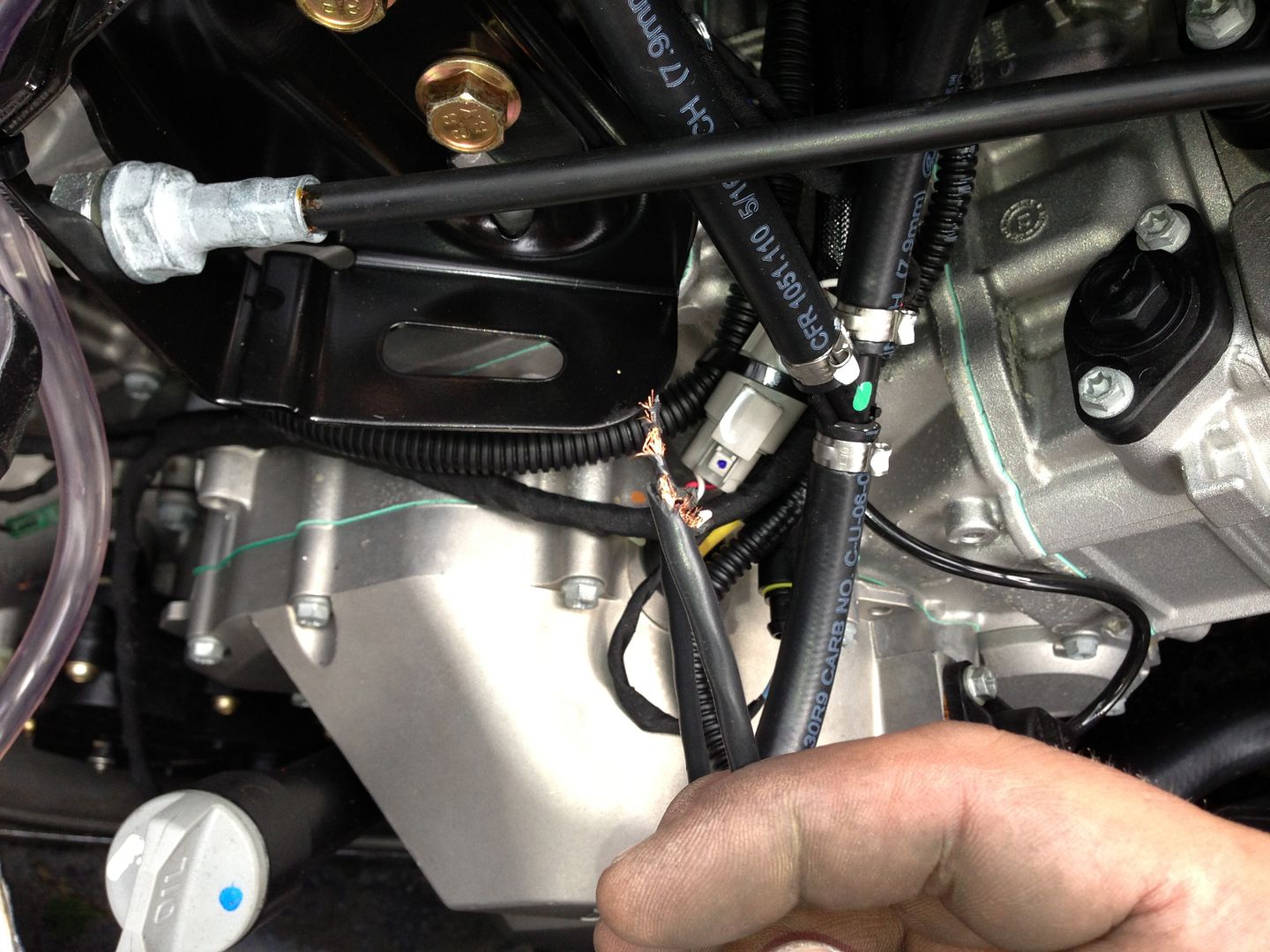

My buddy brought home a maverick 1000 Friday.
soon as it was off the trailer we noticed the speedo didn't work. we checked it and the speedo wires were all chewed up by a RAT!!!! (bought it in farm country)
well, we start out, 3 miles in to it, he is ripping it up, blows the rear tire sidewall open (that was his own fault).
we go and fix it, 3 hours later, right rear axle took a **** and snapped in near the diff and from that happening, the belt blew at the same exact time!!!!!
and get this.....ZERO MILES ON IT!!!!
I cant wait to hear what the dealer has to say about this!!!
