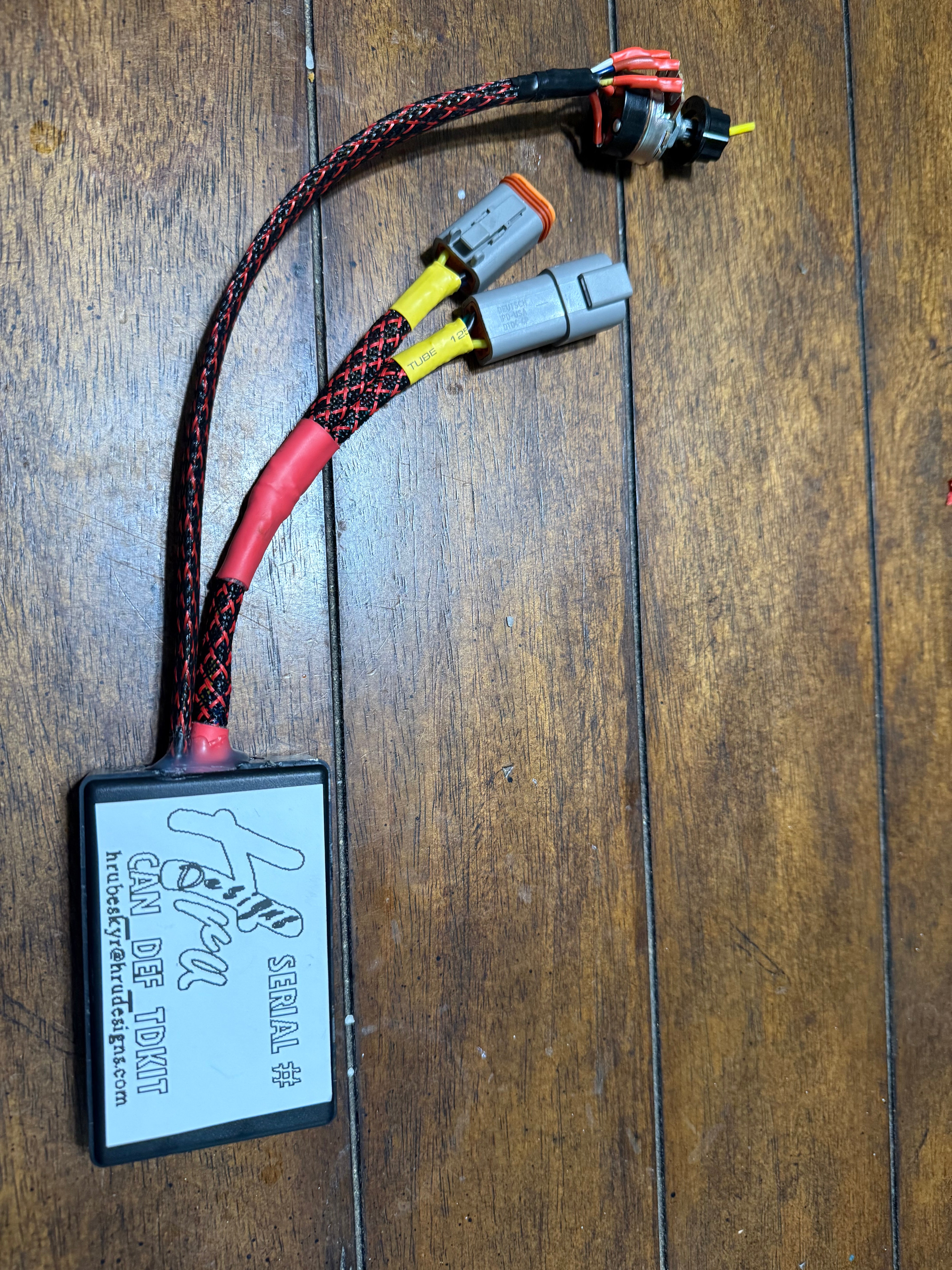

I purchased the EuroTech Electronics product and am very pleased with it. Upon opening the box, it appeared like a lot of wiring. The installation actually was straightforward and fairly easy. There is a good diagram which they will email to you that clearly shows where to make wire connections. There were 6 wires that have the male spade connectors on them that are inserted into the OEM wipe/wash plug (switch side is no longer used) and the other connections were plug-ins for the two new dash switches and two plugs for the “brains” module. Everything fits easily inside the housing and it works! The only disappointment is no user changed timing delay like a car - instead you will specify a choice of 6,9 or 12 second delay and they build and ship that delay timing. You retain normal “always on” switching and using the washer will cycle 3 wipe strokes after the spray. Unlike some delay timers which interrupt the power mid-cycle and stops where it is, this always returns the wiper to home each time it cycles. Found my calls and emails promptly answered and they were great to do business with.
