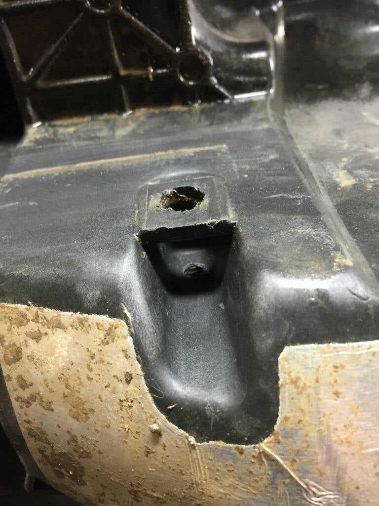

Is the hole where the screw went thru on the top of the airbox? If so, could you see it by taking a pic with a cell phone by putting it in the airbox?
#4 · (Edited)
That picture is actually on the very bottom of the box. That heat tape is the factory tape that is on the box. If you have a smaller phone to get inside the clean portion of the box then yes you can. Soon as you enter the clean side it is on the bottom of the box about 3 inches forward.
In my case the hole was harder to see with a phone but after I figured out where it was I could definitely tell it was a hole in the picture from the inside. It also makes it easier to lay flat on your back and slide up under the bike for a better view instead of crouching beside to bike trying to find it.

#13 ·
I'm almost positive you got the same issue I had. You can see the first picture inside the clean portion it looks like a hole but not a perfect opening.. it's where the bolt cut through the plastic and just pushed the plastic in. Almost like it threaded into the box.
