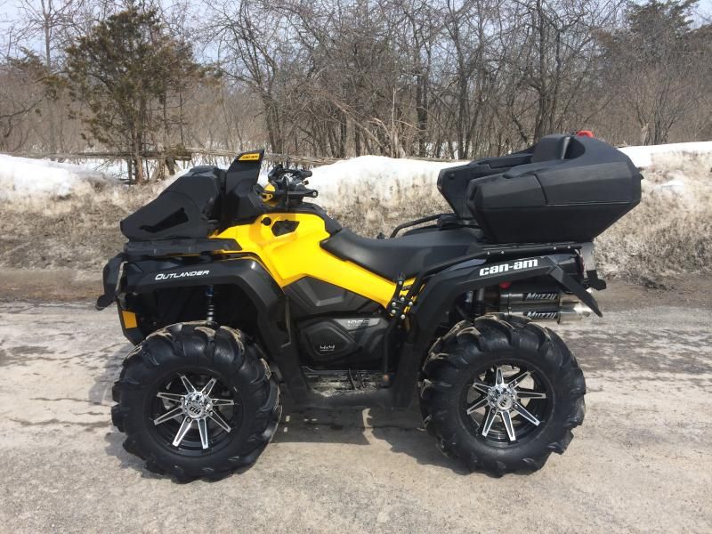

His is my 14 800 I did basically what you are saying and having an all around bike , cv tech clutch, brp snorkel and rad relocate , 28 inch zillas 1.5 wheel spacers , rox risers and fly bars, blinky box rjwc exhaust ...and of course stage 4 elkas

2014 1000 XT-P Max, rad-relocate, snorkels, 2" HL lift, Full dual muzzy, Power Commander V w/dual auto-tune, and QSC/STM clutches, and 29.5" Terminators, 2" wheel spacers, brp beadlocks.
