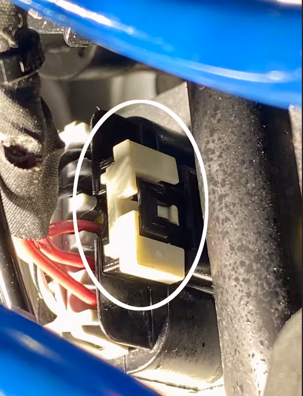

Update: I have now tested with a new battery, but unfortunately the error persists. - My battery guy didn't have a new battery with the right terminals in stock, so he let me borrow another one so that I could test with jumper cables. But nope.
I also disconnected the cable connector that goes into the DPS unit to check for corrosion, but it looked fine. Unfortunately I was about to say.
Grease had been used also here (as was also the case in rear fuse box).
By the way, if anyone else here should ever need to disconnect this connector, the trick is to first pull out the white bracket (which function is to keep the connector locked in place). Perhaps common knowledge for most on here, but I for one had never seen this variant before.
