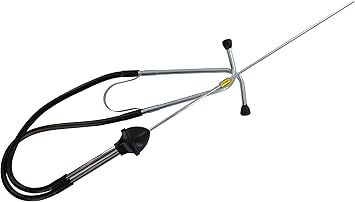

You might try one of these and see if you can pin-point where the sound is coming from.
I've never actually used mine to diagnose a problem, but they really do work well.
ABN Mechanics Stethoscope
